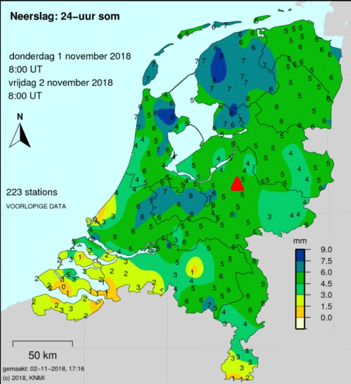

The topo chart is from the Dutch KNMI these are handmeasured rainvalues by volunteers , they are verified. Measurements are always over 24 hours these are the measurements from nov 1st 8 UTC till nov 2d 8 UTC , I am located where the red spot is drawn , the rainfall was 5 mm in that timespan.
I’ve extracted the values over the same timespan from my weatherstaionsoftware (I’ve used local time UTC+1 for the same timespan. The sky sid measure 10.89 mm = 10.9 mm so I had about 2.2 more measured with the SKY , it’s improved but not yet good. I did not expect you can fix this so soon but thought it was a good idea to let you know my observations.

@spacesnow I had in the same period 8.7 mm of rain, and you little map shows 5-6 (note that the map is from 8.00 till 8.00, but I added the amount together, so 8.7 from wf vs 5-6 from your map
Yes that map goes from 8 to 8 UTC thats how the KNMI measures when there’s no DLS as I said and those charts are mostly completed at the end of the day in the meantime they are provisional https://www.knmi.nl/nederland-nu/klimatologie/geografische-overzichten so you need the amount from your SKY from 9 to 9 (we’re in UTC+1) I think you had also to much rain registered.
