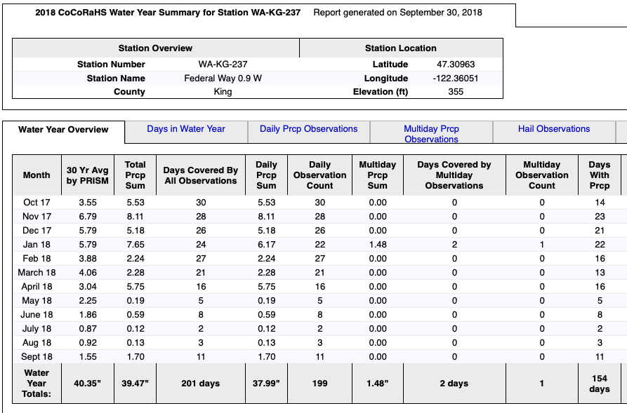

Thanks @dsj @vinceskahan . I did signup and am uploading CoCoRaHS info daily (although at 8:30am, cannot make the 7am w/ kids schedule).
update - it ‘is’ pretty cool seeing your yearly summary data on the CoCoRaHS site.
00%20PM
I updated my no-rain days with zeroes through their site, which has a nice web interface for catching up on stuff like that. Great community weather site !
