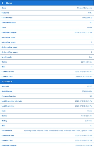

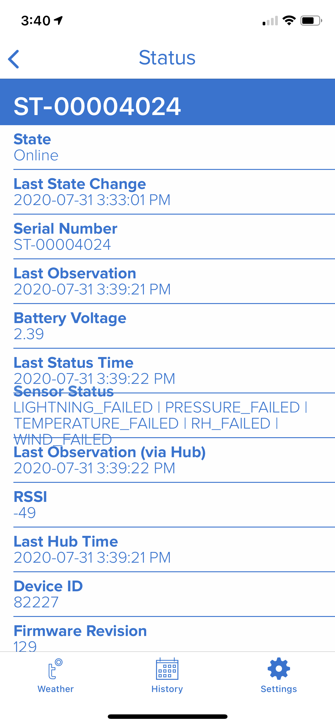

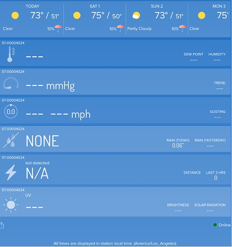

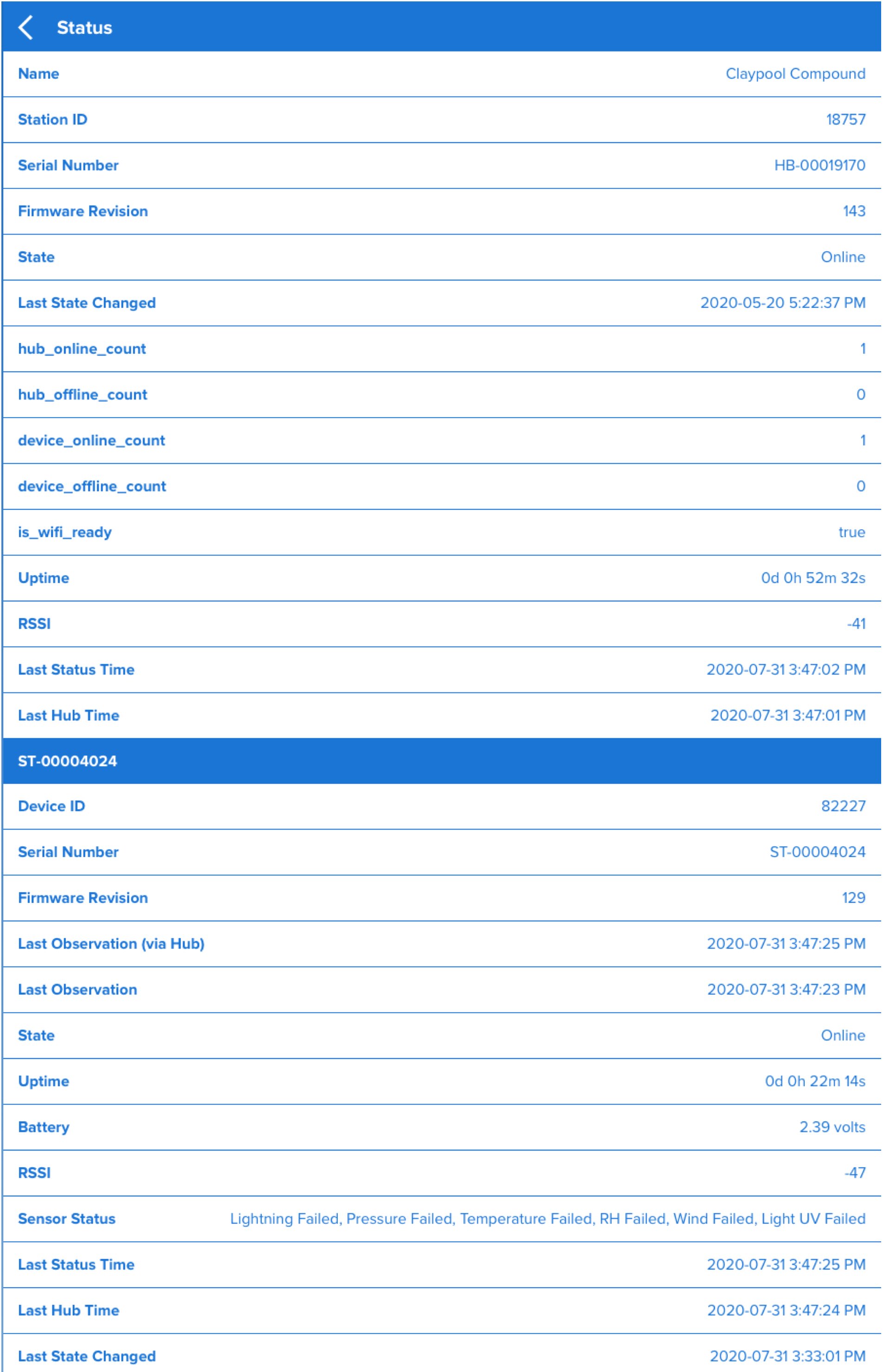

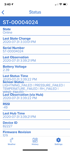

Not getting any info in the fields for my tempest. It is saying that all the sensors have failed. I have attached 4 screenshots showing what I mean (from the iOS App and the web portal). I have tried resetting the device and repairing it 3 times without change. Any suggestions? Not showing up in app or web portal (iOS 13.6 and Mac OS 10.15.6)

Is there a new firmware? I have 143 installed on hub and 129 on tempest.

Latest hub firmware is v143 and latest Tempest firmware is v134 and is just being rolled out, that is why I pinged @eric to see if he could send an update command for your specific station to see if it is a bad case of the “hidden egg” as @GaryFunk put it.
I was able to find my data on underground. It indicates that the sensor stopped transmitting on 07/25/20 in the early morning (2:30a or so).

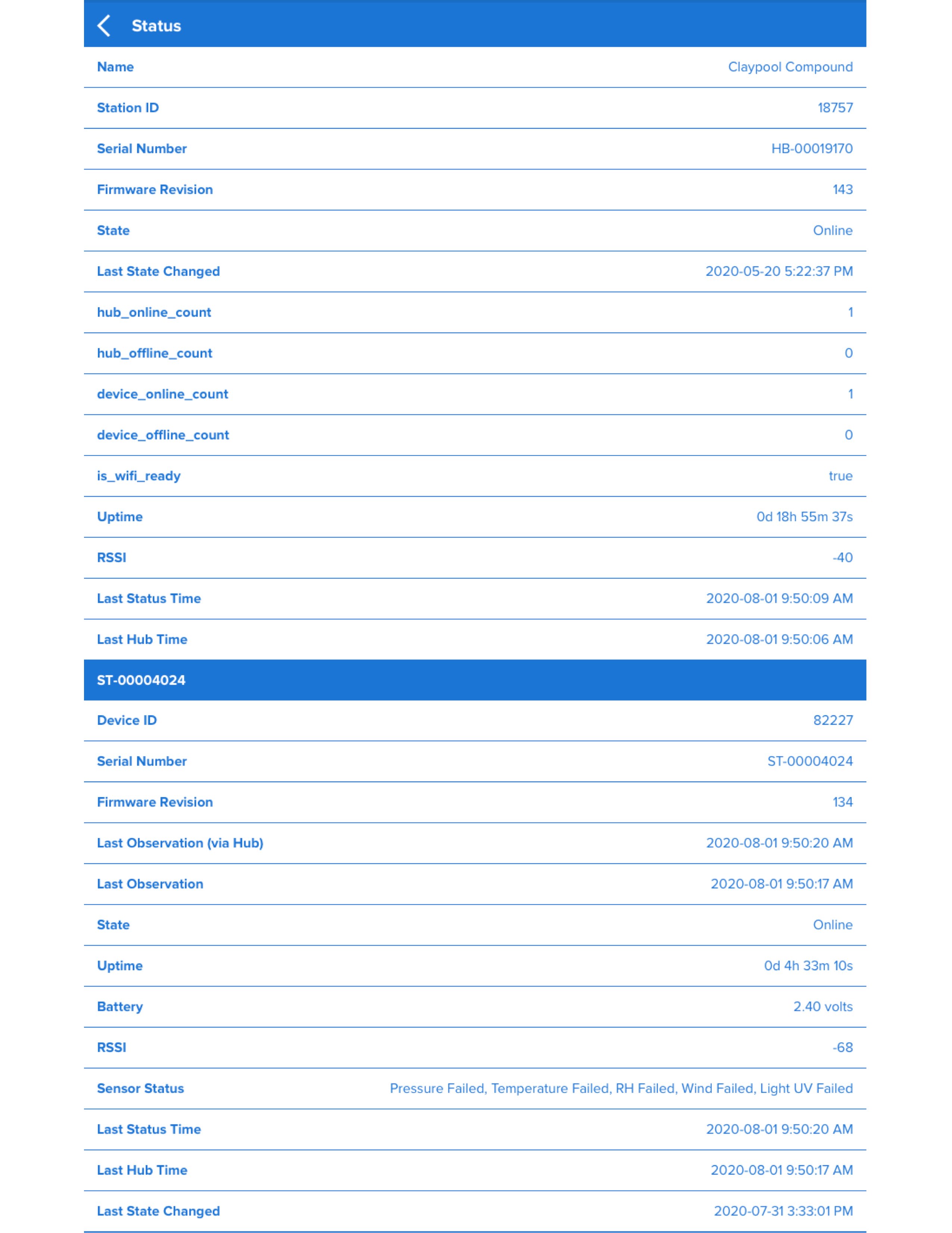

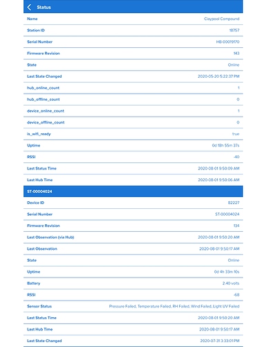

I am now apparently at firmware 134 on the Tempest without significant change to the status and still no data on the main screen.
That is a bummer. If the Tempest is easy to reach, I’d power cycle it and then if that didn’t work, reset the Tempest and then do a Replace Device to relink it with the hub. Beyond that, sounds like a replacement is needed.
