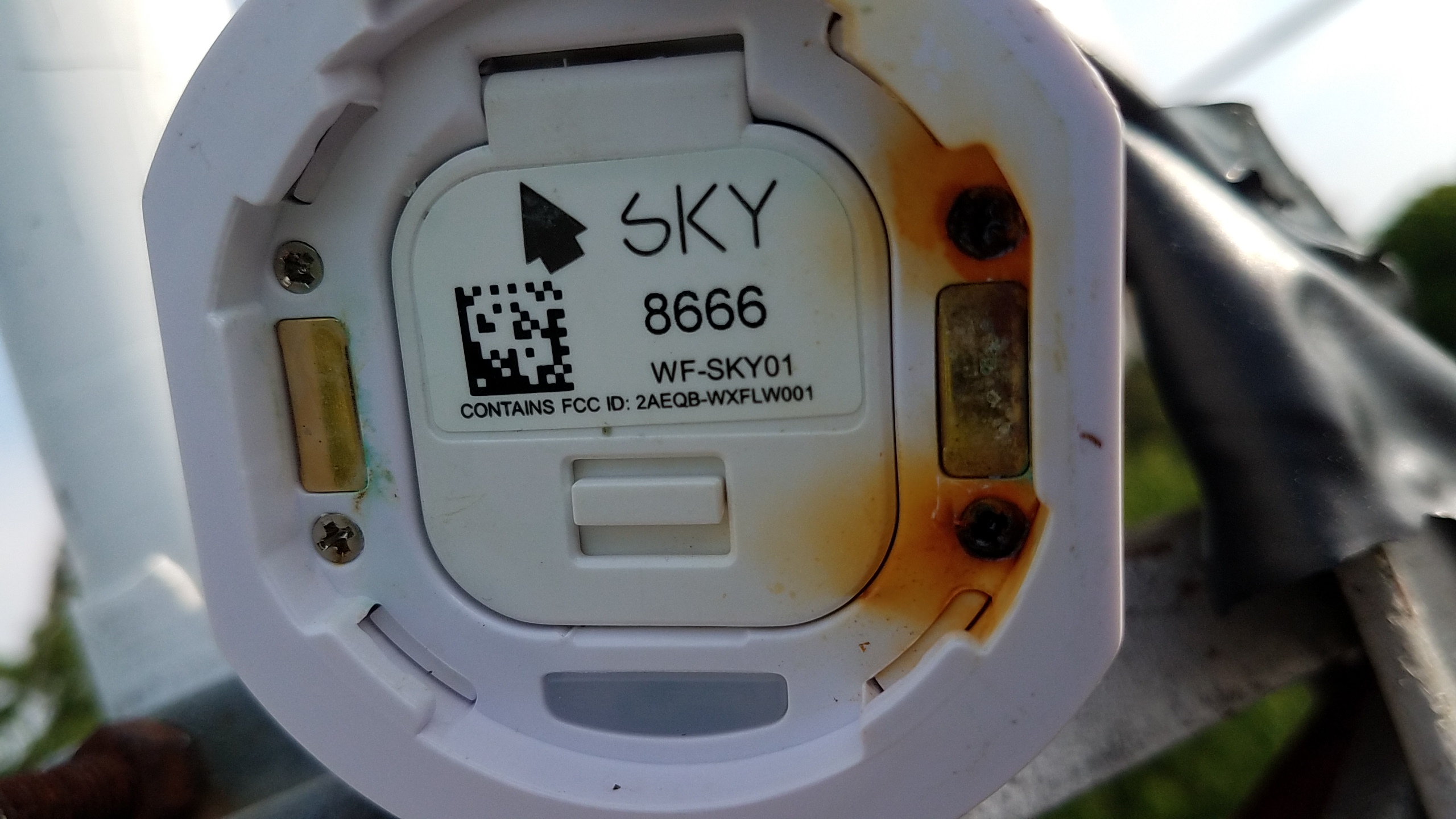

My WF has also died. Finally got someone to climb up the tower for me. Solar batteries were dead and the unit was full of water. Tried to use batteries and the unit worked for a few minutes then died. Trying to wipe it all down and salvage it.
My unit was replaced back in Feb or so of last year due to water. Still have the bad one in a box. I have no idea where to ship it back to.
Here are some pics with the rust I now have on the bottom of the unit. Yes it was tightly locked in place.
If I shake my solar panel I am getting water out of it.

Not sure what to do now. I am going to stay away from WF systems. Hopefully WF will get this one working again. Not sure how to remove the rust build up.

that doesn’t look nice indeed.
It is known that a batch of solar panel had problems with water ingress. Seems that should now be solved, at least those that are been send out recently.
Regarding the sky getting full of water … that is weird as I have several since day one and none ever got any water in it. I do remember some having trouble with the light sensor … it was not properly installed and leaked slowly. Maybe yours is one of those unlucky ones.
In any case, open a ticket with @wfsupport I’m pretty sure they’ll help you out.
And next time do what I do always do, tape the several parts … when i see those tiny seals :smirk:

Do not like the rust, once you get rust it eats everything.

I used both Dow Corning 4 dielectric grease, and then taped it too. They clearly are early on the learning curve for both the SPA and weather seals. I bet they get it right soon though.
The gold contacts with DC 4 seem to be holding.
Wow that rust looks awful. I bet the battery hardware (contacts and springs) can rust too, cringe worthy just to think about it. Agree, once rust sets in, it is usually down hill from there.
I think some stainless hardware should be considered too. Stainless hardware might not be that expensive in large quantities.
Bottom line is the seals though, which clearly in many cases are not working yet.
So far I have heard nothing from support, The rust really bothers me.The SPA appears to be dead. I have tried to dry it out and it started to take a charge then dropped to zero again. Will try and use a hair dryer and see if that helps. As for the air, I am still trying to dry it out. When I took the SPA off there was ice in between the seals. I might try to add batteries today. Hopefully it will come to life.
