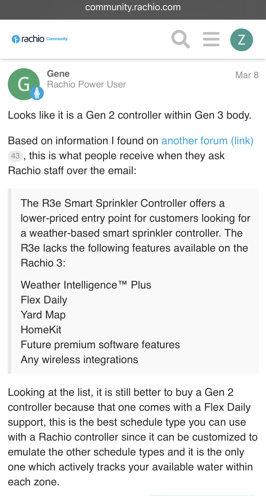

@MiamiWX, do you know if the R3e the same as the version 3 when it comes to compatibility with the Tempest? Hey, looking to save money where I can. Thanks!
I honestly don’t know, but I found this post for you which may help you to decide…
The link for the whole conversation is here: https://community.rachio.com/t/rachio-3-vs-3e-comparison/22601/3
