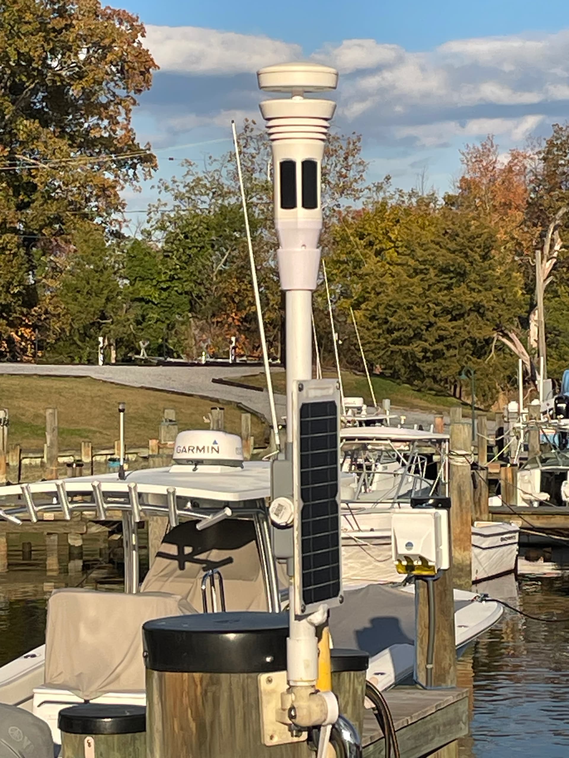

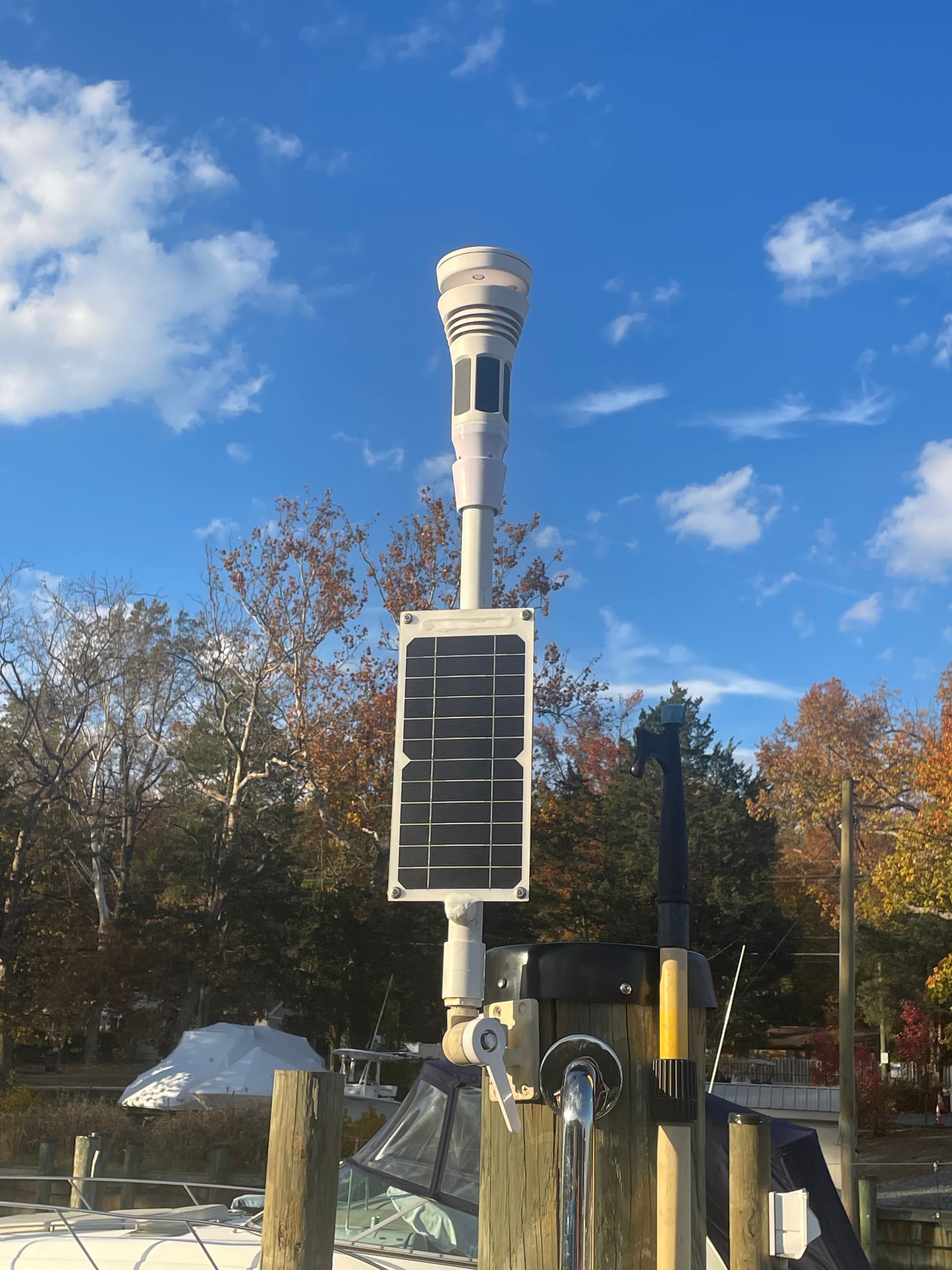

Tempest weather station with external solar panel is now in service broadcasting data from Smiths Marina, Crownsville Maryland. This valuable weather instrument was saved from the landfill hopefully to spend many more years of providing important weather data.

So…it would appear that the solar panelsl on the ST device itself have been disabled in lieu of the larger solar panel or. . .are all of the solar panels working together?
The solar panels are unplugged from the circuit board and rendered inoperable. (I may have mentioned in a previous post) Thanks for asking. BTW the aux solar panel is way more than the unit requires but has a usb connector and is regulated. The buck boost allowed me to adjust the voltage down within the range of the internal battery. I would like to find a smaller solar panel with a usb output. So you come up with something, please post it. If you have any other questions related to this install, please ask away. Thanks
