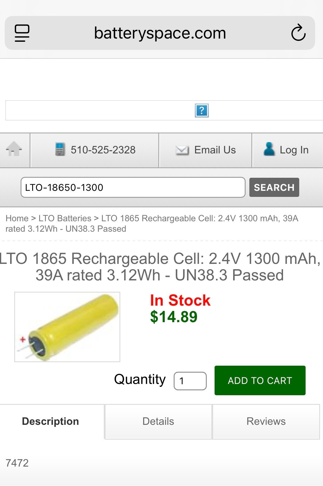

Before I replaced the existing battery i checked the voltage and it was 0. I took a strong searchlight and shined it on the solar cells and the voltage came up. I then replaced the battery and the station came to life! I reinstalled it outside and it was operating fine for about a day and then stopped updating data..its been a few days now and getting plenty of sun but hasn’t updated since. The last battery voltage reading was 2.56. I will take the unit down and check to see if i can find out what went wrong.

18650 batteries are pretty universal and you can find pages and pages of then listed on Amazon as well as online retailers that specialize in flashlights.
Sorry but I don’t get a single one of LTO 1865 with pins like a capacitor on Amazon.
Not all batteries meeting the the same volt & mah specs are the same size. The Tempest has an internal opening that can only fit the battery part number I posted in a previous post.
This is the correct dimensions: 18.7mm(0.7") x 65.3 mm(2.6")
From Batteryspace.com (LTO-18650-1300)
Not on Amazon..

It looks like my solar battery finally failed in my sky unit. The unit is about 5 years old. I’ll hopefully take it down soon and check it out. I noticed your post, and saw that you purchased a Lithium Titanate (TLO) 18650 battery, this battery has a significantly different voltage (2.4V vs 3.2V) and charge algorithm as compared to what I think the original lifepo4 battery chemistry is/was. I’m not surprised it failed. I’m not sure if I’ll be able to find a replacement radial leaded lifepo4 battery or not. Do you have any pictures you can share of the original battery and how it was installed?

Hi Bryan, unless yours is different from mine, the picture of the replacement battery is shown with the installed original battery in the background. (See thread for pictures).The replacement I purchased from batteryspace.com is the exact replacement, However, it did not solve the problem. I decided to unplug the solar panels from the main board and connect a power supply in parallel with the new internal battery and this worked. I am now working on adding an outboard solar panel to charge the battery. Your electronic knowledge is obviously greater than mine so I appreciate your input. Thanks
