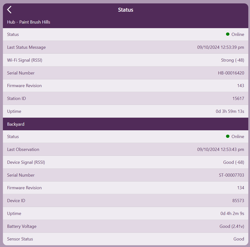

My old original Tempest (Serial Number ST-00007703, Hardware Revision 1, Firmware Revision 134) has been taken out of the closet its been stored in since September 2020 (we moved from the house it had been installed at and due to life, just never tried to set it up at the new house). I was a bit surprised when I turned the power switch on and a light actually showed up on the button. I’ve taken it outside and letting it get sun. My hub connected right back up to my network, and after leaving the Tempest outside for an hour I’ve got it now connected back to the Hub. Battery shows 2.37v (was 2.36v when I first connected it).
So I’m curious. Has anyone else tried to resurrect an old Tempest? Any bets on if you think the battery will even be usable? Would like to get this running again and not have to buy a new one, but will play it by ear (might be better to just buy a new one anyway. Opinions?).

Mike. . .you can submit a Support Ticket for your station. . .to see if they can bring the Hub up from FWR=v143. . .to the current of v194 . . . and . . . bring ST-7703 up from FWR=v134 to the current of v181 !
That’s the plan. Battery Voltage now up to 2.41v (so no longer in power save mode).
BTW: Anyone know if this can get the newer firmware updates, or is it limited to older firmware versions? I assume the updates still come down overnight? (no way to request an update)?

Chat’d with support and they said they have it scheduled for pushing out new firmware. They looked and said my hub can’t take a newer version for the hardware (the Hub was from Field Test, and then I did the discount to get a production Tempest only (no new hub) so I’m guessing that is why.
Glad you Chat’d with them and at least ST-7703 is back in operation…soon with an updated FWR.

Tempest battery gets a little more voltage each day. Up to 2.48v.
Still no updates so still stuck at v134.

Mike. . .for the past few days. . .I’ve been seeing this. . . .
HB-00016420 = FWR v194
ST-00007703 = FWR v181
Interesting. The Tempest app on my iPhone isn’t showing that.
Is there somewhere else I should be looking?
you may have to delete the App. . .then reinstall it. That sometimes cures issues. I obtained your Station data via the webApp

I killed the app and restarted and it shows v181 now. Ok cool, that makes me feel better. And nice the hub updated too. May get to stay with this original version for awhile!
