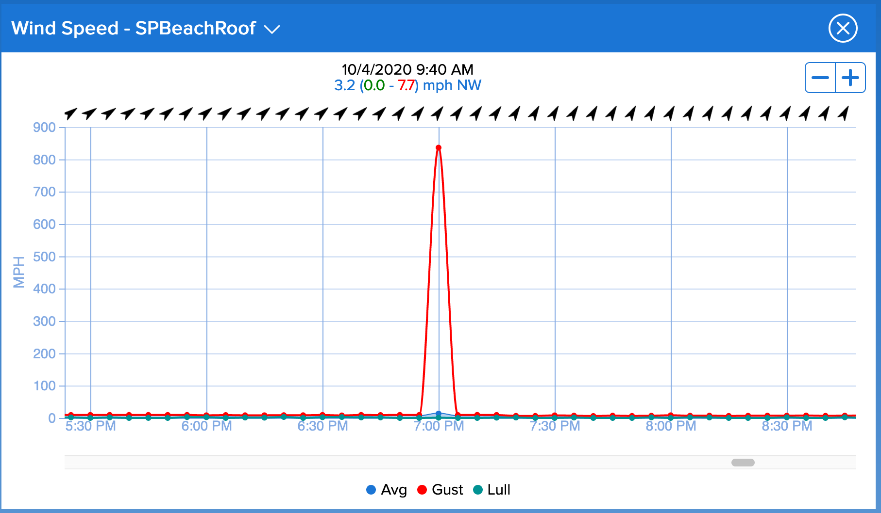

Another issue I discovered this morning. I was looking at my wind chart and couldn’t figure out why the scale seemed so weird. Then I scrolled back and found that last night it recorded a wind speed over 800MPH. :open_mouth: Obviously not a real reading … It would seem like the AI or at least some type of bounds-checking would catch something like that. It’s also frustrating that now my wind charts are virtually unusable due to that anomalous reading.
Definitely reference this thread in your support ticket. That is some strange stuff.
