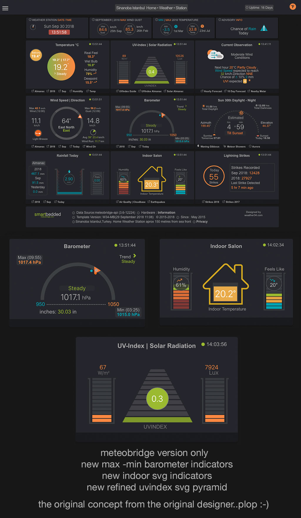

the meteobridge version got some updates to the visuals and some minor fixes raised by piet,william,ed .

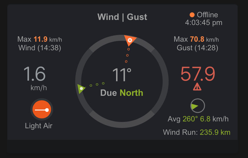

I use the weatherflow hardware in conjunction with my other hardware . weatherflow hardware is used for UV-index,Solar,Lux,Wind Direction,Wind Speed,Balcony temperature using a seperate meteobridge hub . the positive note the weatherflow wind sensor out performs the Davis 6410 anemometer at significantly low calm winds speeds .weatherflow displays low wind speed values when the davis is still waiting for a reasonalble 3-4km/h gust to wake up. very very noticeable under relativley calm conditions visually and data wise…
this is also observed frequently by another user using a sonic wind sensor from a another manufacturer.
and at the other end of the scale the weatherflow is on par for recording high wind speeds i recorded a max of 84.6km/h in the week the anemometer recorded 84.8km/h and it tracks almost identical in the mild-mid range…

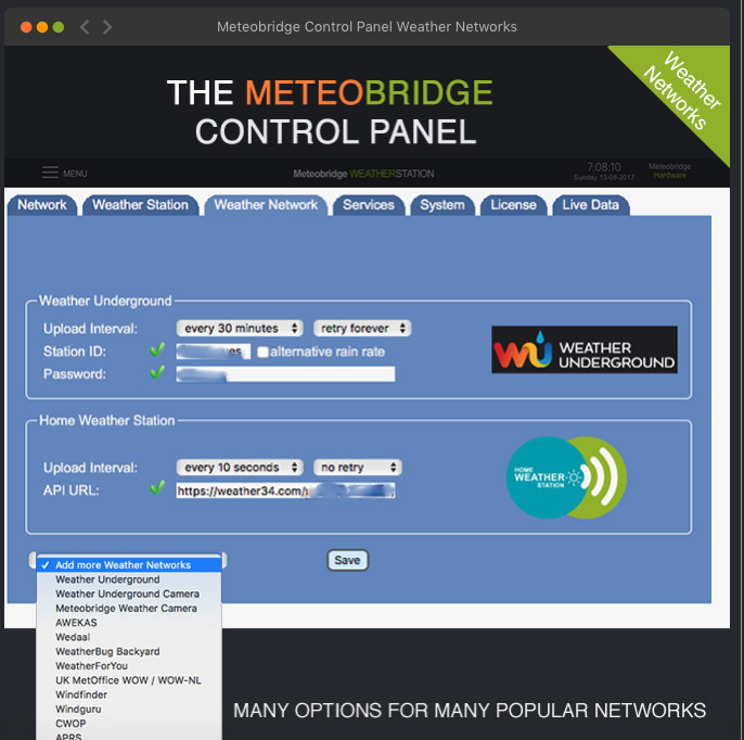

Good Morning
yes you need to have the weatherflow HUB as that is the heart of the communication for weatherflow hardware what meteobridge does without the need of 24/7 dedicated computer . It basically opens up many many options
you can send to multiple weather networks simultanousely ,store data , create max/min data values for each day,each hour,each,each year , store data directly to mysql, send your data to multiple templates not just this one
.meteobridge has a built in API specifically for this template itself simply simply choosing the home weather station icon and enter the path where you want the data stored on your hosted server or local server ,many users send data from meteobridge to there own servers (localhost) .it is basically a self sufficient tool and once setup it requires no manual input it jsut runs and runs until you need to update the firmware via reboot. its low powered just like the weatherflow hub , in my case meteobridge actually powers the weatherflow hub.
mbw34
here is a write up https://weather34.com/homeweatherstation/guides/mb34.html i did last year which gives you the basic idea of many options avaialble to the weather enthusiast. most importantly its develped by enthusiast of many years .

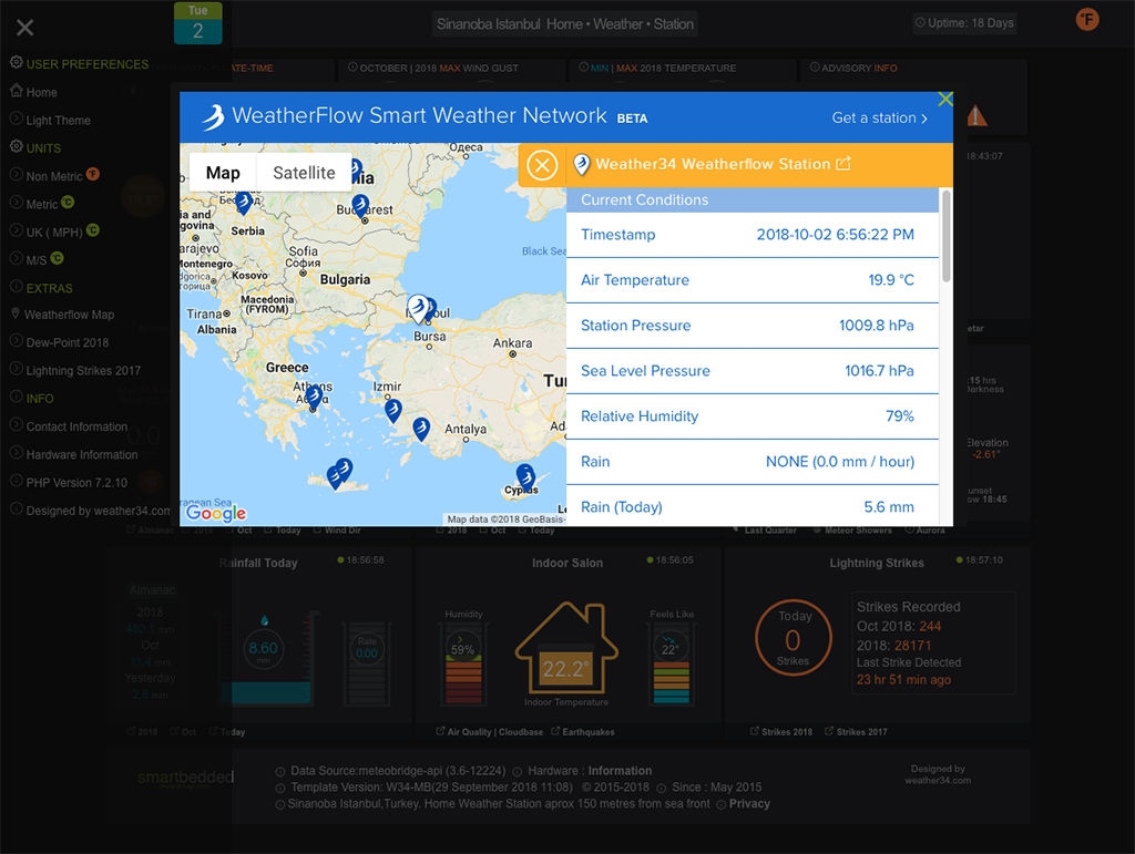

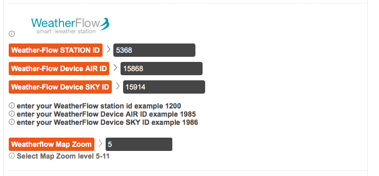

sent a new download link to david it simply includes a link to the new official weatherflow map using the menu in the template. if you have not noticed its also viewable by the default weatherflow template in the map .
it simply centers based on the lat lon settings within the template at zoom level 5-11 choose via the setup screen
