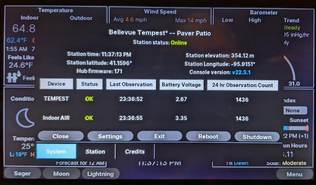

. . . Important Discovery . . .
The Shutdown" Button does not cause a “Shutdown” and “Reboot” Button does not cause a “Reboot” of ‘wfpiconsole’
Touching the “Menu” Button in the lower right of the display brings up this screen. . .
It used to be. . .upon touching the “Shutdown” Button. . .would cause ‘wfpiconsole’ to gracefully end / terminate all running processes at which time the screen would go blank. . . allowing for a power turnoff at the isobar surge protector box. Good Night ‘wfpiconsole’ ! I could then turn it off at the end of the night because while asleep. . .my eyes are closed and I don’t need to see the display anyway.
However. . .now . .upon touching the “Shutdown” Button (and the “Reboot” Button for that matter) . . .the ‘wfpiconsole’ does NOT gracefully “Shut down”. Rather. . .it goes to this screen. . .
This then forces me to sudo shutdown -h now but I would really prefer that the “Shutdown” Button to handle that operation for me (like it used to) because when typing. . .I have then bring up that little tiny on-screen keyboard in order to type the sudo shutdown -h now command. THAT then readies ‘wfpiconsole’ to be powered off for the night.
Bottom Line is. . I really do miss the functionality of the “Shutdown” Button. Same goes for “Reboot” — those Buttons were very Handy . . .USEFUL.
@storm_tracker and @padamec - my bad! I forgot to test the Reboot and Shutdown buttons before the release. It was a simple fix though, so they will be back in the next version (hopefully within a day or two)

@Peter. . .just ran wfpiconsole beta . . . but now. . .none of the 4 buttons on the bottom respond to touch. Now at Critical Juncture. . . .Cannot shutdown the console what-so-ever except to do a Fatal Hard Crash by killing the power head-on and running the risk of destroying the SD card.
why do updates always cause sooooo many issues! If you plug in a keyboard you can stop the console with ctrl-c. If you have to power cycle there is a chance the SD will fry, but it is pretty small (I’ve done it enough times without it happening!) I’ve clearly gone and broken Pi3s while trying to fix for Pi4s. You can run wfpiconsole update to get back to the stable version and I will keep trying to fix things
If I choose to Bail out of the display as seen above. . .is there a way to UNdo the beta? In other words. . .revert back to the previous version (v22.3.1) and just accept the fact that I should not use the Shutdown or Reboot buttons.
I don’t wanna fry that SD card. . .but otherwise my display is locked to what we see above. " If you plug in a keyboard you can stop the console with `ctrl-c ". But can’t plug a kybd into the console because the Console is stranded! I can’t Bail out of the display w/o doing a complete unplug of the power. . .hence SD Card High Risk.
Yep, just run wfpiconsole update and it will move you back to the stable v22.3.1
Guess I’ll just have to cut the power and take my chances – eh?
Yea, I’m sorry! I didn’t mean to lock you out ![]()
Just cut the power. . .waited for 2 mins. . .then turned isobar surge protector (switch) back on. Just re-ran ‘wfpiconsole uppdate’
WeatherFlow PiConsole update complete!
Just ran ‘wfpiconsole start’. Display is present. . .but the buttons on the bottom still do not respond to touch. Same situation as above. The display is locked and can not get to anything. Hence have no way to go back to the “Menu” screen to see what version it is.
