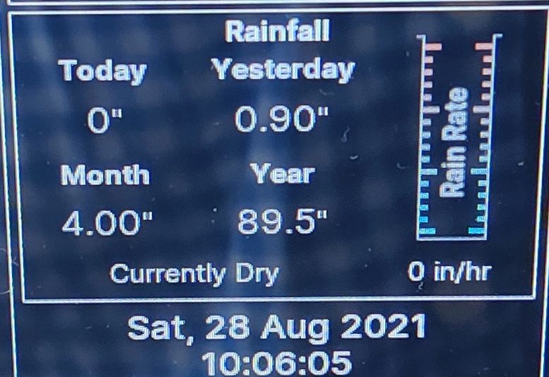

Where do the rainfall month and YTD numbers come from? The today and yesterday numbers are reasonable, but my annual number shows 88 inches. We’d have to be living in the tropics for that kind of number!

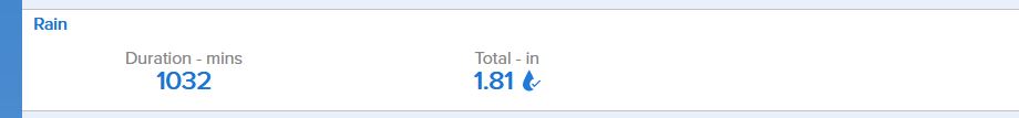

And just as a follow up, I’ve screencap’d the Tempestwx web page. There’s definitely a disconnect:
Tempest Month to Date:
tempestwxmtd
Tempest Year to Date:
tempestwxytd
PiConsole:
Took a look at the code, but didn’t see anything that jumped out.
Thanks for the comparison - I’ll take a look and see what is happening. One thing to note is that the numbers showing on the Tempest webpage are RainCheck’ed values. Those on the PiConsole are non-RainCheck’ed values. That might explain the discrepancy (although it is quite large!).
Edit: might be worth turning RainCheck off in the app and seeing if the values change/match the PiConsole
Yep, that’s it. The non-raincheck value match. Will ponder this. The raw values aren’t accurate at all.
