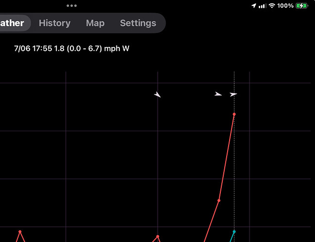

Over the last few days, my Tempest has had periods of time where the wind speed will spike very high and the wind direction will be wrong. For instance,’right now, the wind speed is below 5 mph out of the W. Per the screenshot, you can see what the Tempest is actually displaying for wind info. And then at some point, the Tempest starts showing the correct wind info. Station id 173594.

I wonder if the errors are due to humidity. Here’s a graph of recent temp and dew point for your station.
