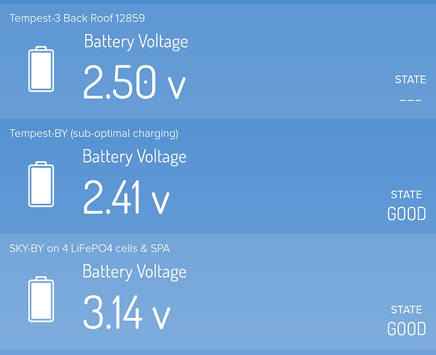

For the battery card view. . .at the far right. . .it only has STATE
But the Android version shows. . .
The difference being. . .in MS Edge the word " GOOD " underneath the word STATE is missing!

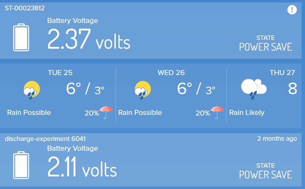

my webversion now reads in very big letters “Power Save”, that’s new!
(btw the other station is basically off for two months, which you might think off as an extreme version of powersave :wink: )
Wow! The words “POWER SAVE” are interesting. . .indeed! That’s a “collector’s item!” We could’ve used those words during Field Testing 2 yrs ago.
On Android. . .two out of three of my Tempest devices are okay, showing GOOD, but ST-00010365 still shows " — — — " .
The MS Edge versions are all back to normal. . .just has they have been in the past.

I just sampled several Tempest stations over interior Alaska. . .that I know have been having trouble because they only have 3 1/2 hours of sunlight this time of year. Their stations show 2.37v 2.36v and 2.34v respectively and also have POWER SAVE.
If I remember correctly. . .when the voltage got down that low. . . the terminology was " LOW " then after that " REPLACE " .

it still is REPLACE for when you have a Sky or Air unit. There is nothing to replace with a Tempest.
Seems odd with a Battery State of GOOD… that I’ve lost sensors… LOL
I know… 2.11 volts is NOT good… just surprised with all the issues around battery reporting lately that I saw this.
