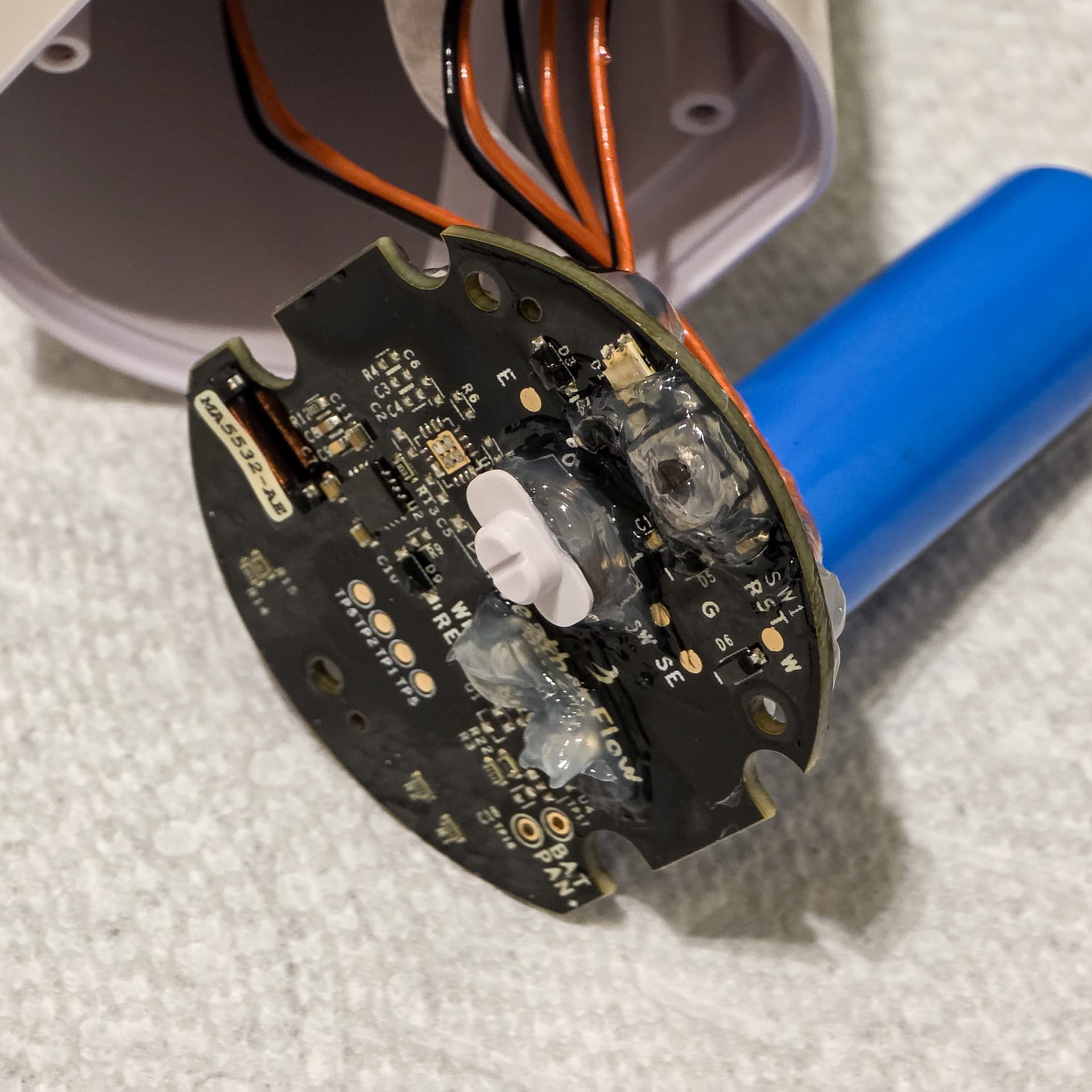

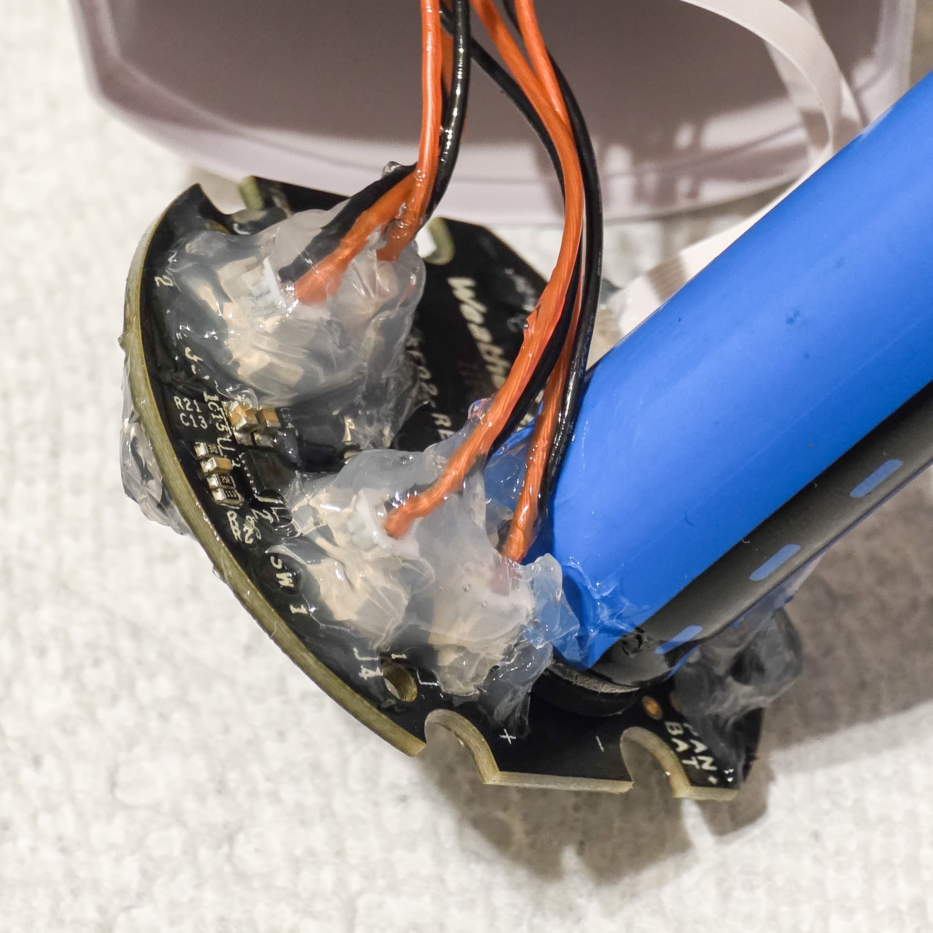

Tonight, I opened my late-2022 Tempest, and found gooey gobs of silicone covering all of the connectors and the solder joints of the battery.
I’ll now ponder my next move. (Now I know my next move, thanks to a reply below.)
This is known as “Dielectric grease” ; it is a non-conductive silicone-based lubricant that is used to protect electrical components from dirt, moisture, and corrosion and is used extensively on the bottom PCB (PrintedCircuitBoard) of ALL Tempest devices. There is also a PCB under the “TopCap” (dome) of the Tempest that is “Smeared” with LOTS of Dielectric lubricant to protect all of the connections located therein.

I’ve had to work on several of my past Tempest devices. The lubricant is very “messy” to work with but it is necessary to keep the corrosion as close to the Zero as possible. If you use a cotton swab to remove some of it so you can work on your device. . .save the swab and REsmear it back on to the components when you are finished.

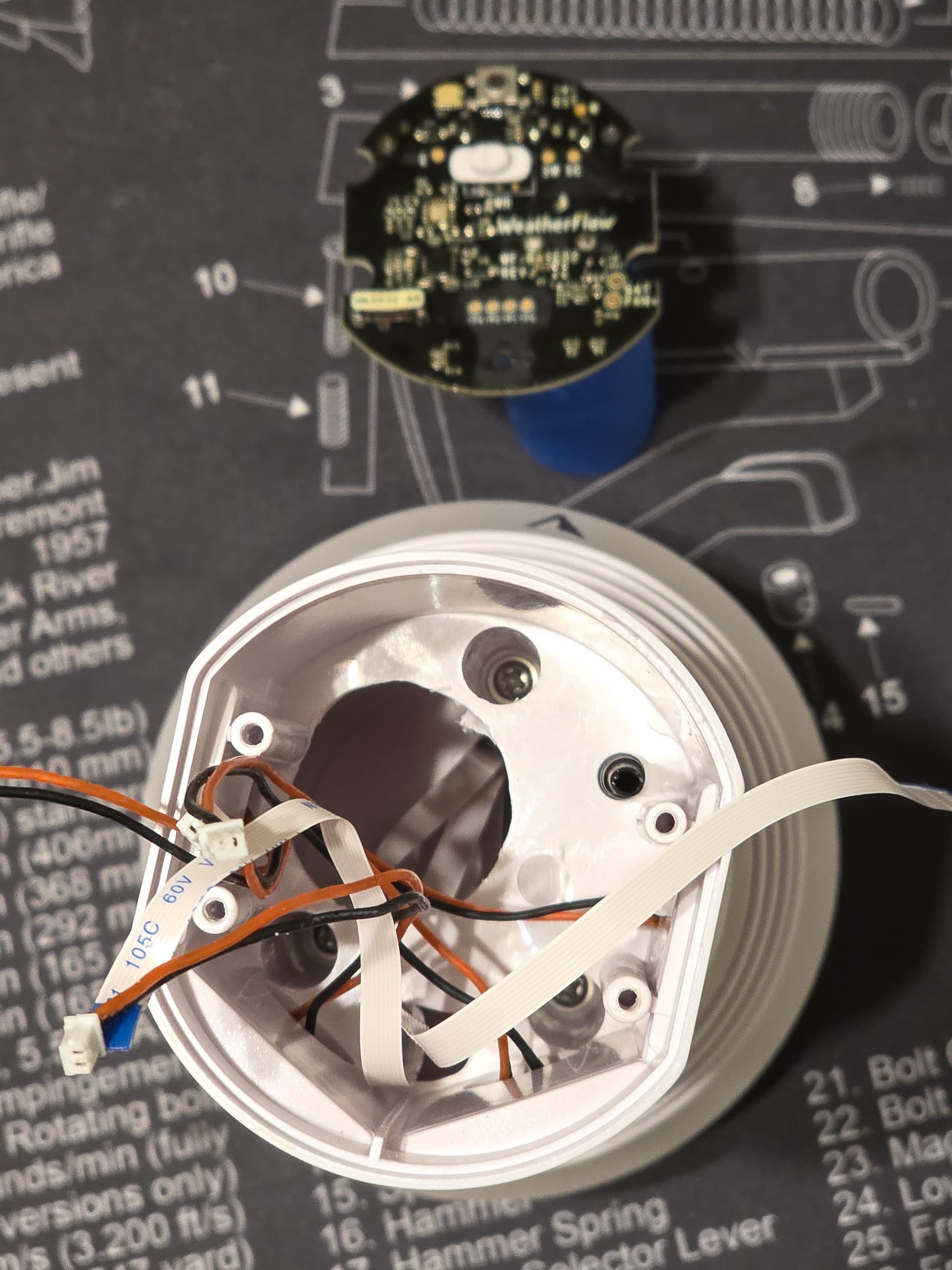

I used swabs and contact cleaner to remove the grease, then went to work with my old soldering iron. The original battery came out easily. It was bulging at both ends, having endured a hard life in the Texas heat. I bent gentle s-curves into the leads of the new battery, then soldered it in.
Removing the battery cavity wasn’t difficult with my Dremel, but plastic dust is no fun to manage and clear away. I wrapped the battery in a few layers of blue painter’s tape to snug it into the wider hole.
The ribbon cables are very finicky, as others have noted. A few tries were needed be sure they were clean of grease and seated well, despite them appearing good each time.
While it was apart, I also disassembled and cleaned all of the vanes, including the sensor within. The gadget had collected a lot of Texas dirt and grime, including attempted habitats by tiny critters.

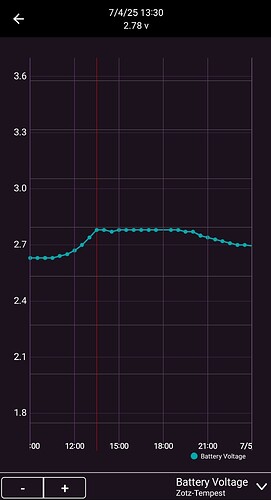

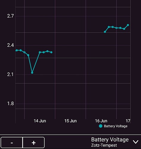

A day in, I can report replacing the battery with a 2500mAh LTO has been worth it. I thank everyone who pioneered this refurb.

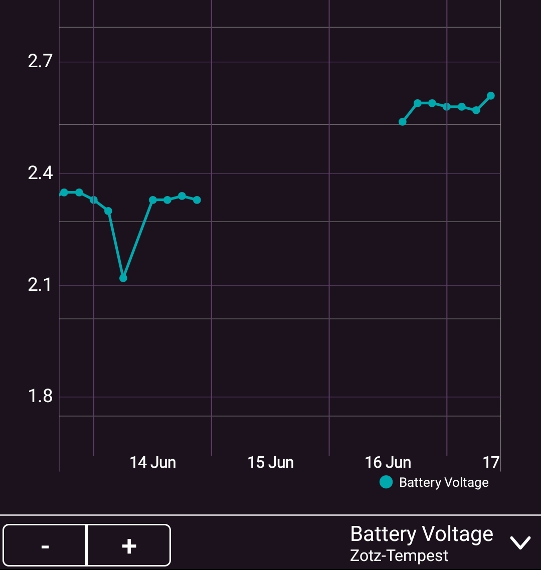

It began at 2.5V yesterday afternoon, reached 2.6V by sunset, and lost only a tiny bit overnight. It’s now at 2.65V, well on its way to topping off. This low-granularity chart shows the last day of the old 1300mAh battery, which dived below minimum after the external battery pack had already been drained.

The original 1300mAh battery from late-2022 had sufficient capacity during its first winter, but I suspect the battery degraded rapidly in the long periods of heat typical in northwest Texas. It ran down much faster during the next winter, so I bought a battery booster to keep it going. Its second full summer must have been brutal, because its endurance during this past winter was much worse. The original battery lost charge more rapidly during the night and during cloudy/rainy days.
The big new battery is up to 2.67V today. :+1:

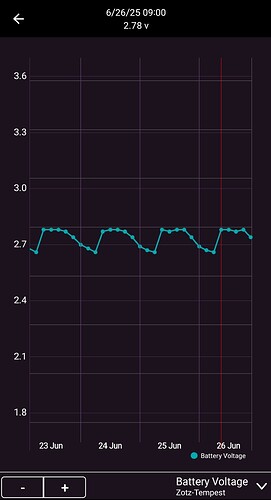

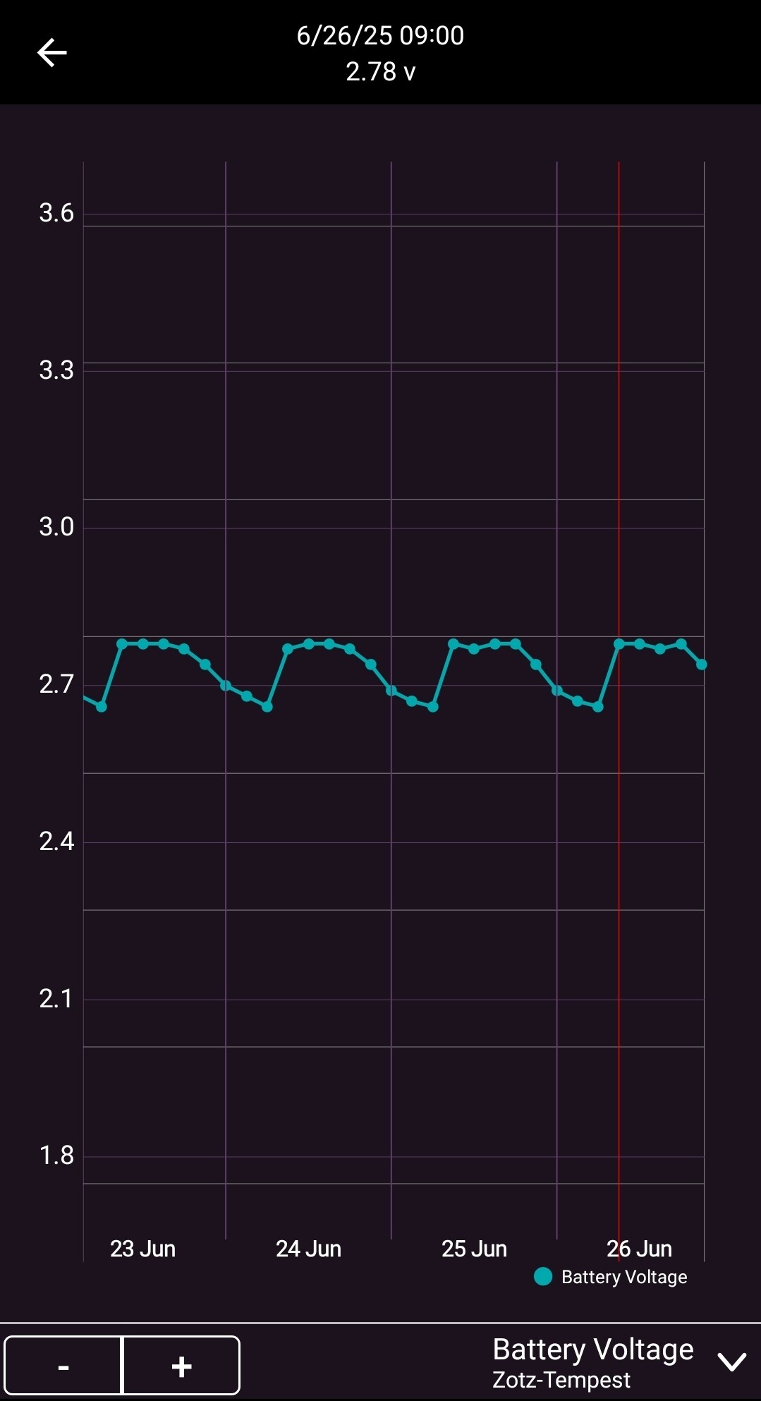

My Tempest has performed perfectly since I modded it last month. During clear days It charges to 2.78V by 9:00am, and has performed exceptionally well during consecutive rainy days. The sun emerged around 10:30am Friday, and the battery was topped up by 1:30pm.
