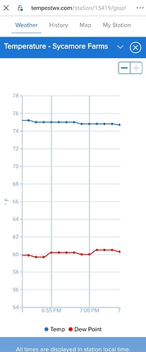

Just noticed I am missing 10 mins of data between 6:55pm and 7:05pm CDT today. All graphs so the same gap in data.
Station ID:15419

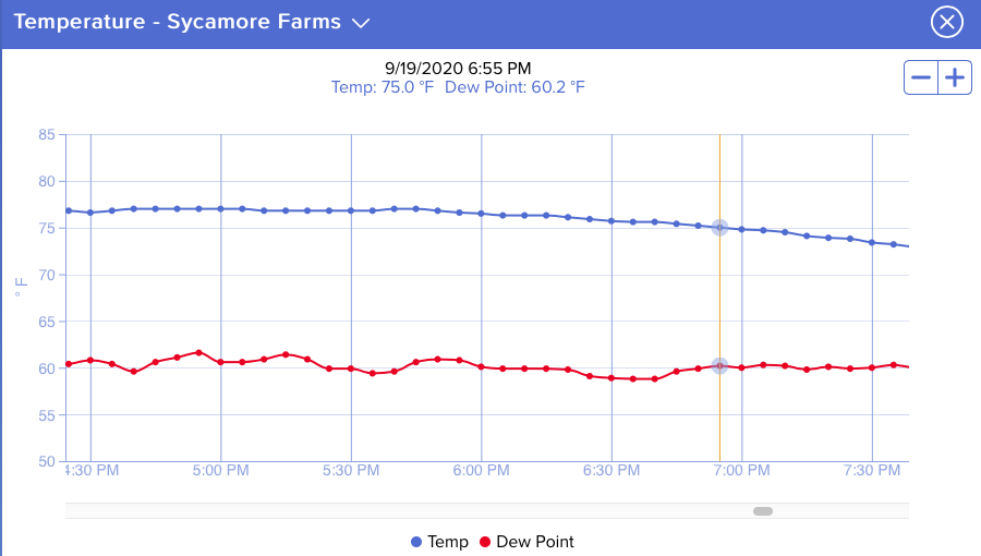

At first I thought maybe your Tempest had a firmware update but zooming in to the 1-minute level shows no missing data.
So, how do you explain the difference in the graphs?
The graphing algorithm and how it rendered. Obviously the data is there, otherwise it wouldn’t show in the 1-minute data.
the different levels are calculated every x time from the 1 minute data (called buckets internally). Sometimes there are small glitches (heavy load, maintenance etc) but mostly this is corrected with the next run.
As you can see it was corrected since
