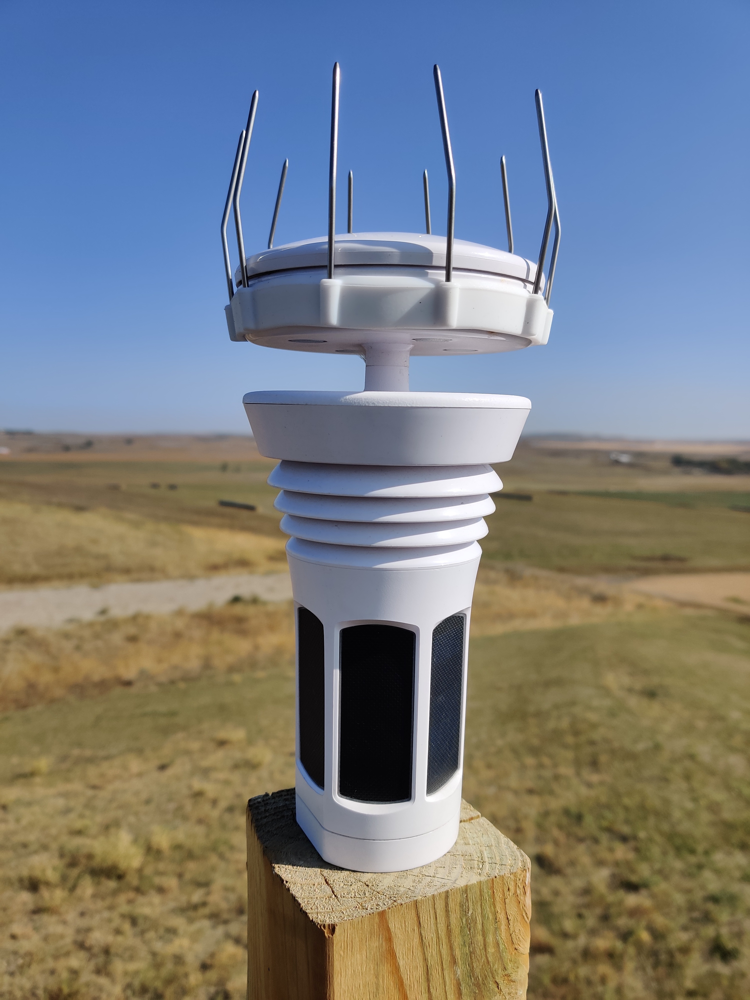

And as a followup, Iāve installed the āofficialā Tempest bird Deterrent. Very pleased with how it looks and hoping things will be much quieter next spring when the birds are most active.

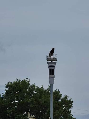

I have had this installed for several weeks. Birds are able to land in the middle of the spikesā¦additionally, the thing will occasionally pop off and fly several feet from the device. The spikes need to be MUCH longer and bent inward at a better angle to stab the pesky birds that are determined to defecate on my Tempest.
they can be bent inwards by rotating them. If the angle itself doesnāt suit your type of birds, put the pins in a vice and bent them to your liking. at least that is what I would do.
Iāve not seen the same issue on our BDA, but Iāve pondered what Iād do if I did and the best Iāve come up with is to rotate four of the spikes 180 degrees and tie fishing line between each of the two pairs. But now that Iām looking at your photo, it appears that the bend in the spike is too low to create a fishing-line deterrent within the Deterrent. Maybe a vinyl cap on each of those spikes would provide a decent anchor for the short lengths of fishing line. Fortunately, this is all hypothetical for our Tempest; sorry you have to actually deal with it, @geeteedan
Maybe use a Dremel with a narrow cut-off wheel to grind a notch near the tip of the spikes and use that to hold the fishing line. The spikes are stainless steel, so if you donāt get them too hot at the point you grind the notch, rust wonāt be an issue.
Ooh, great idea, @gizmoev! Thanks!
