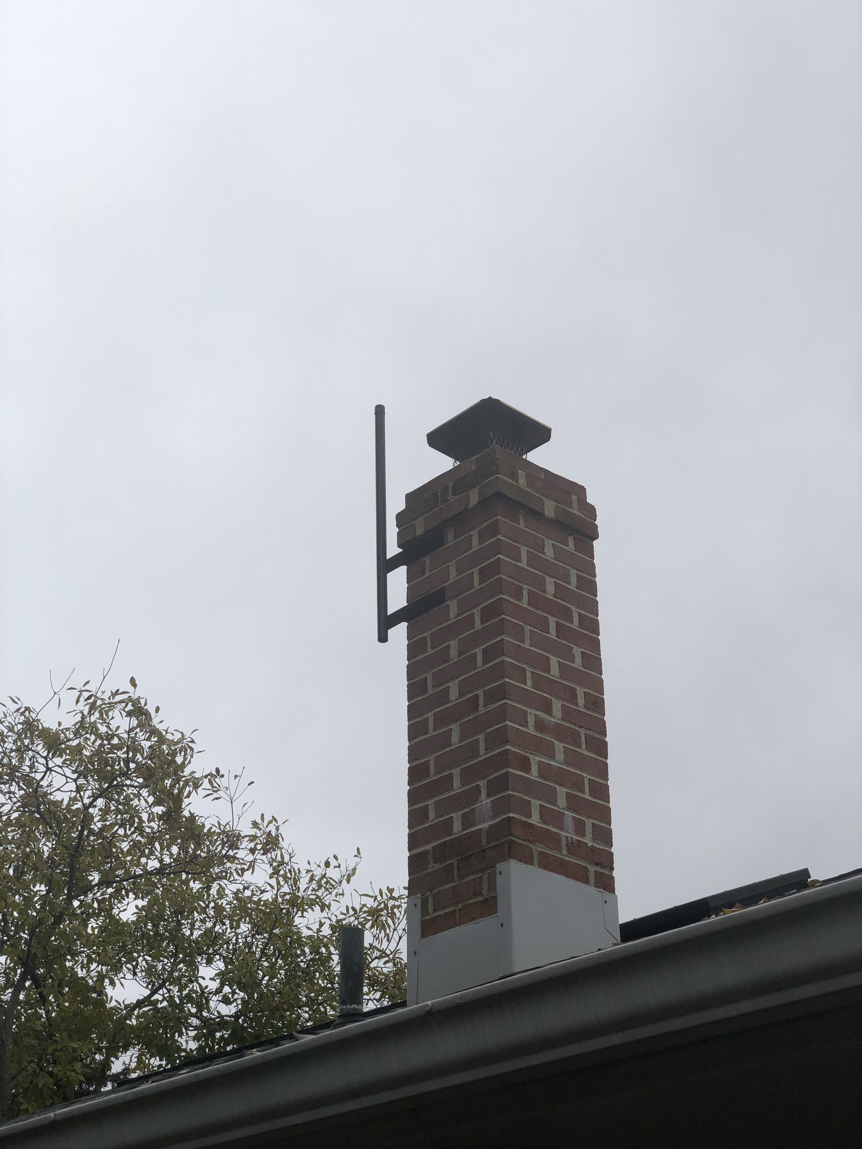

Wish I could show a final install, but this has been on my roof for months. Just waiting patiently :grin:
The tip is about 6’ off the roof top. Hope this is enough vertical separation?
Waiting for Sky.
if this is a working chimney, it might influence on wind sensor as it is very close and heat might interfere direction/speed, maybe change it with a little longer pole ?
personally I do not sit next to a fireplace, the smoke, the heat that rises does not give a good result of measurement
If it is working, soot accumulation cant be good either.
The chimney is an oil burner vent, so soot shouldn’t be a problem. If air currents from the exhaust influence the sensor, I’ll add an extension to the pole. The top is threaded.
Oil Burner - does not look like any soot but please be aware that in some time you will see it. The burnt hydrocarbons become soot and will deposit readily on a coller surface.
I will keep an eye on it. But the inside of the chimney cap has no visible soot, and it’s been blasted with the oil burner output for decades now…

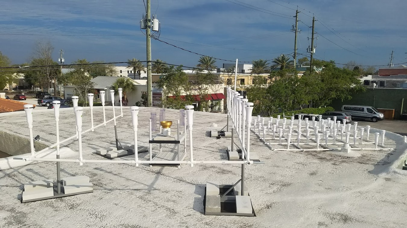

Pretty sure we have you all beat! :wink: Rooftop testing array at WeatherFlow Florida. 65 new production SKYs validating calibrations in real-world conditions. 06 March '18. (Primarily testing for rain and sunlight calibration…which is why they are not mounted higher up for better wind fetch.)

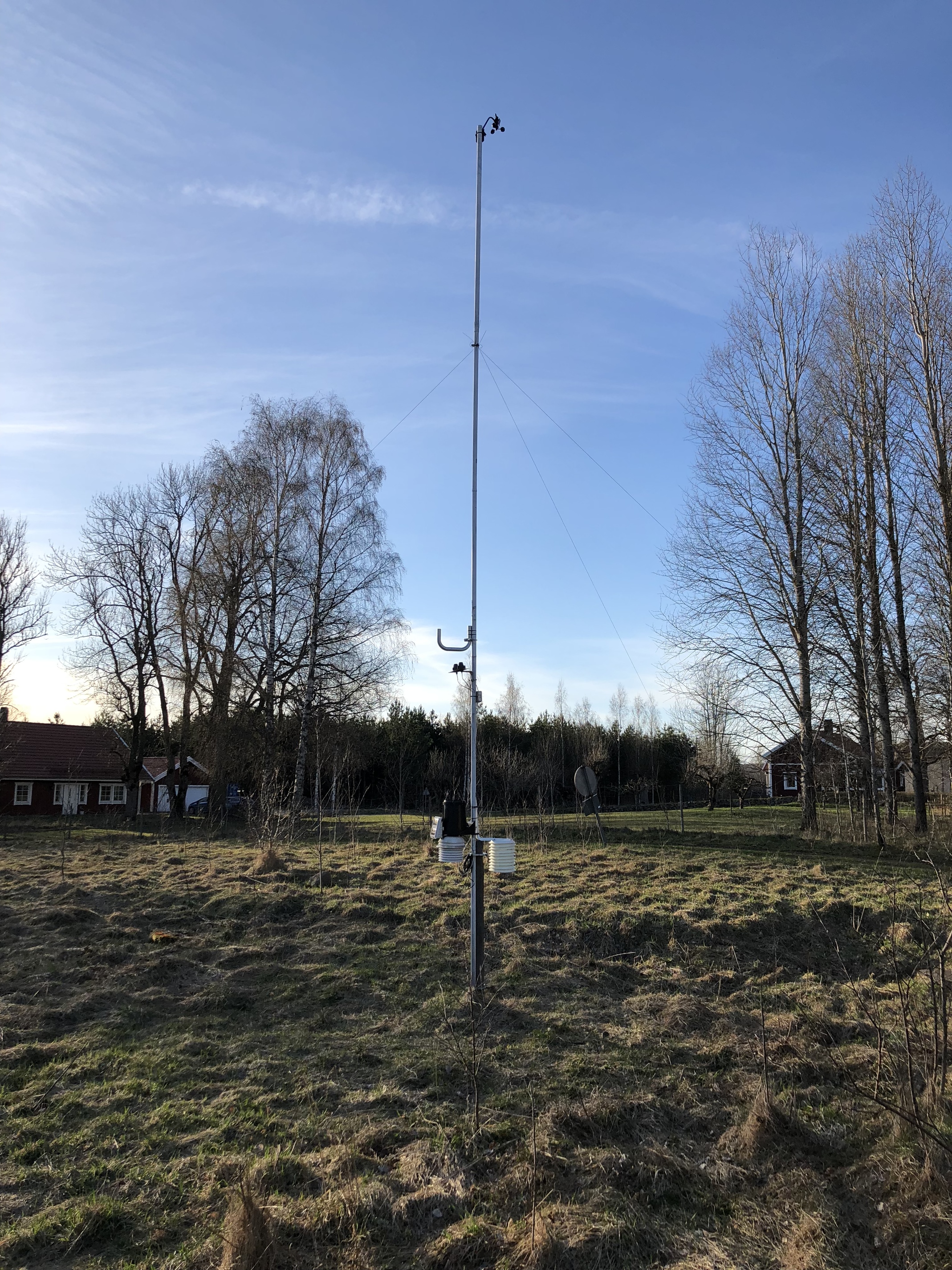

This is where I plan to setup mine. AIR in the right sunscreen and SKY on top of the L shape pole. Next to my Davis. Hoping it will be a good one.
