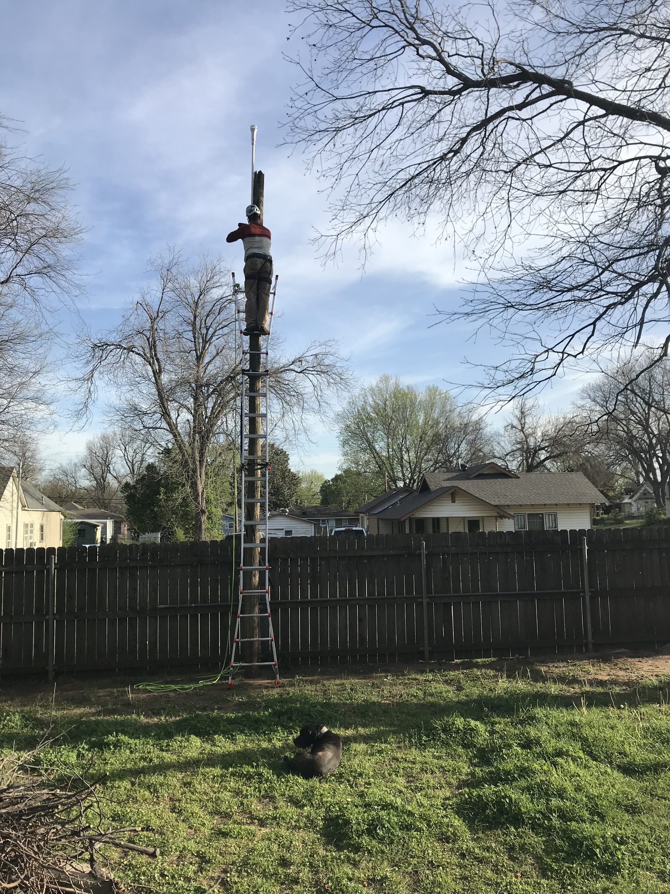

Here’s my new beta SKY unit installation. I have a blasted pecan tree to the west. Otherwise, for living in the middle of town, it’s not too bad. It’s up 26’ on a former security light pole.BenSKY
