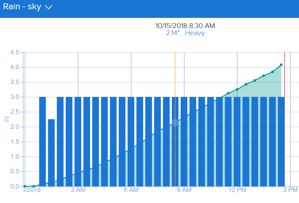

Looks like the Sky got confused and Rain Rate has been stuck in “Heavy” for 12 hours.
Actual rain is closer to 1/2 inch - not 4 inches.
It has been raining - heavy at a few times but not for 12 hours straight.
