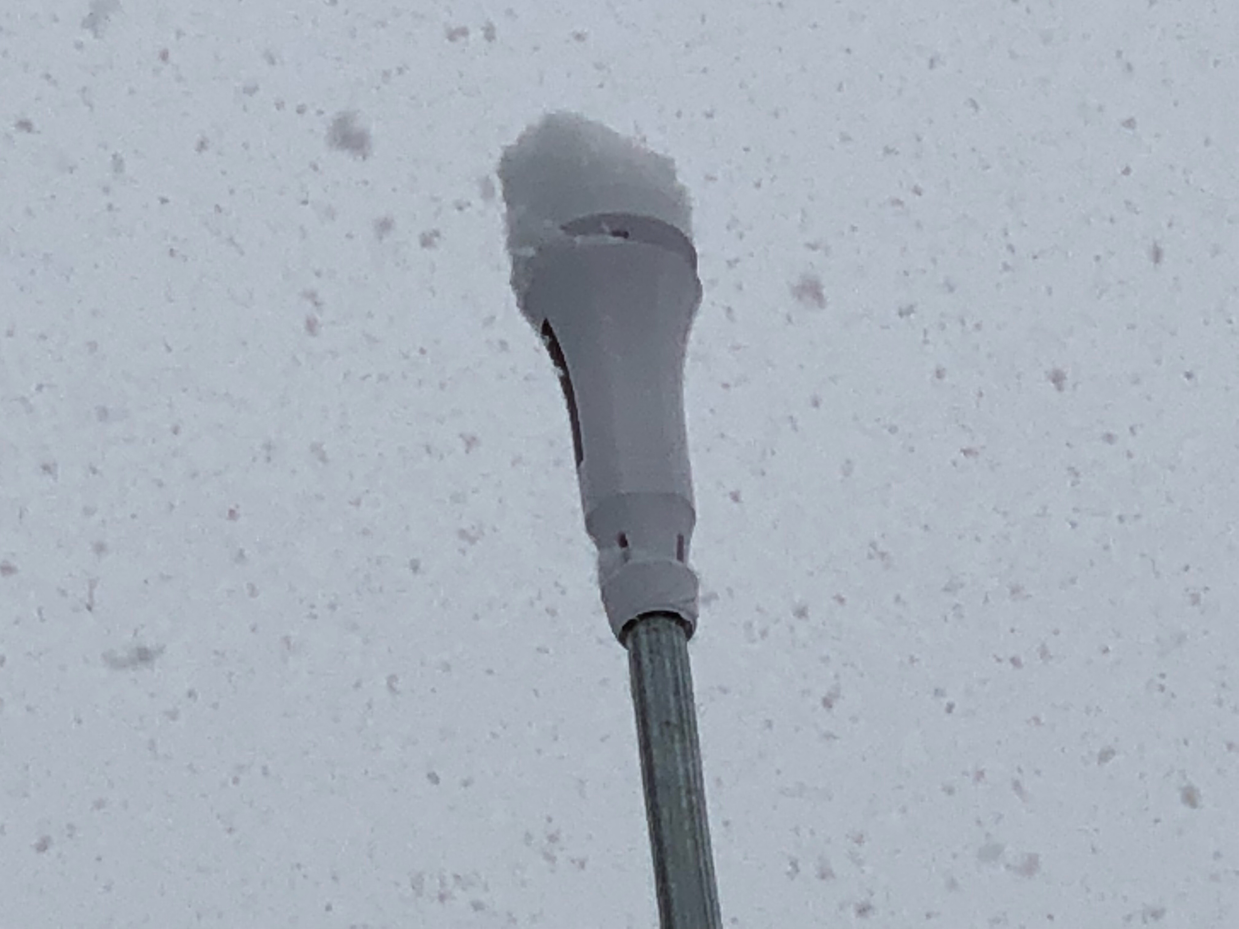

Snow is best measured using a ruler, since it has no appreciable acoustic signature and the Sky has no provisions for measuring water equivalent as it melts…
