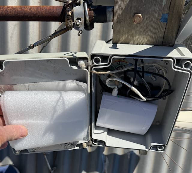

With the hub in the position of this photo the RSSI was over 92 and loosing signal.
There is aluminium tape stuck across the lid of the box acting as a reflector.
There is foam packing maintaining maximum distance from the reflector.
Note the position of the power supply to the hub is nearest to the wiring which was my mistake last time I accessed those wires to repair my camera power supply cable.

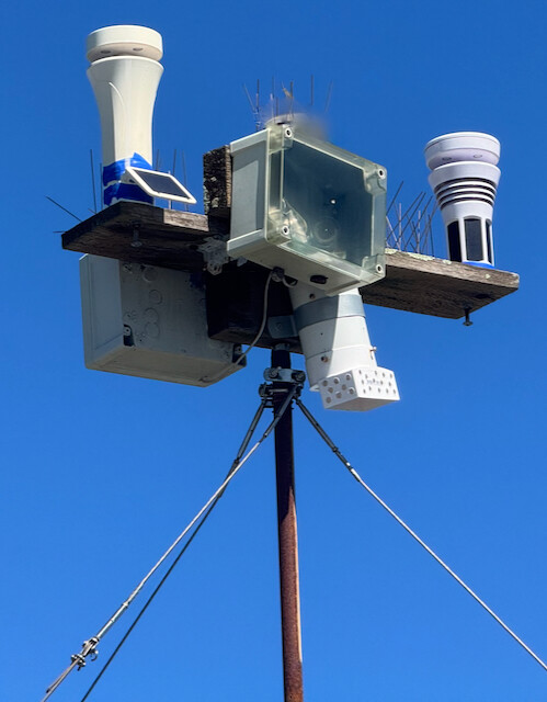

In this position with the pole leaning over the signal would be aiming down into the roof from this pic.
The following pic with the pole raised is taken from the direction of the Sky station several miles away. You can see the plastic box where the hub is mounted on the bottom left side.

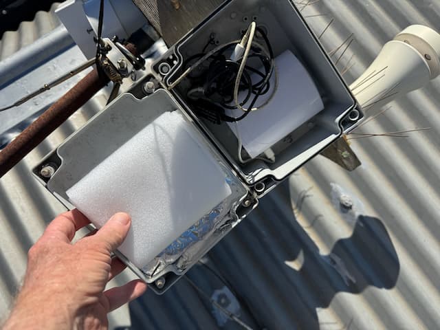

The next pic is showing how I correctly re-positioned the hub which reduced its RSSI to 88.
The plastic box lid then folds over and screws closed.
