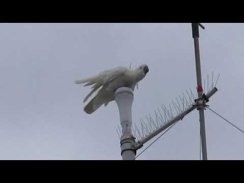

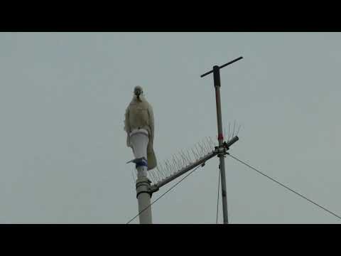

Cockatoos are what generally destroy my weather stations. The wire frame above it is tricky for them to stand on, but they will still try even if they have to hang upside down. They chew anything but their beaks so far have slipped off the smooth edges of the Sky so they have not managed to destroy it.
113520435_231482817851962_6501612054712183610_n
The wire serves 3 purposes. 1. Paragliders will snag less. 2. Birds will have trouble sitting on it reducing poop. 3. The wire supports the lower bracket if a person tries climbing on it.
