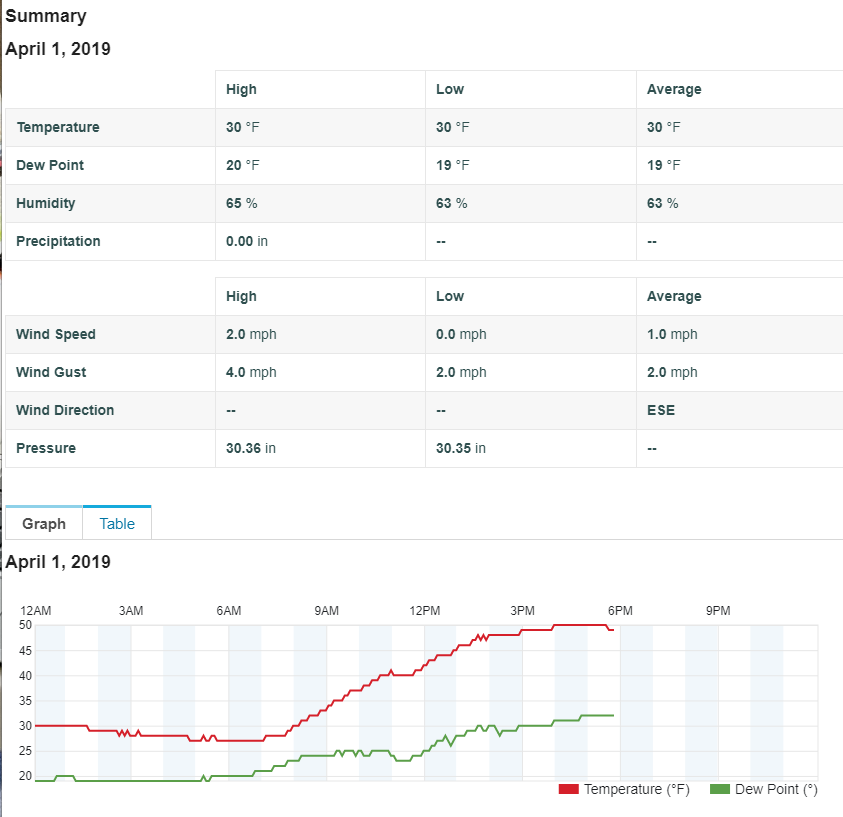

Well after a week of sending data from new station to WU it finally shows as online. However the data accuracy is still off.
table show temp of 30 for all values and dew point never going above 20, however right below that the graph has the correct values. I’d think Big Blue and Watson could get this right?
