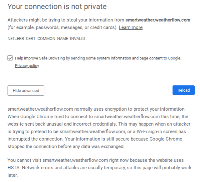

When I try to connect to my weather station, I get a security error related to a problem with the security certificate. I’ve attached a screenshot. Is anyone else experiencing this?
I’m running a Chrome browser on a Chromebook. Chrome OS Version 71.0.3578.127 (Official Build) (64-bit).

I tested using an Edge browser on a Win10 machine and got the security error there as well. I also tried connecting from a different WiFi network, but that made no difference. I’m in the Boston area, so perhaps other regional servers are okay. Otherwise I’d expect widespread reports of issues.

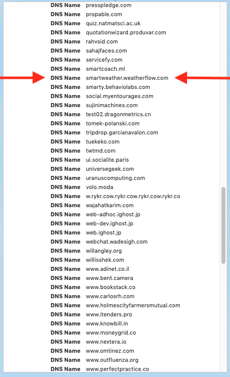

I just looked deeper at the Let’s Encrypt certificate. It contains a long list of SAN hosts (subject alternate names) for all kinds of curious domains around the world. Last time that I checked, Let’s Encrypt did not issue SAN or wildcard certificates. Their web site says that they do now, since last spring. This is actually good news for another project I’m working on that needs a wildcard certificate!

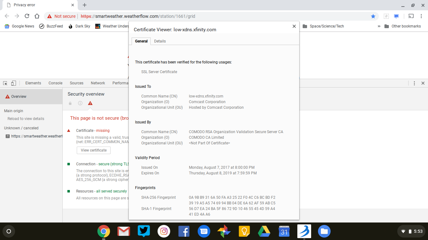

Another screenshot, with some details. I know enough to get to this data, but not enough to be able to interpret it. It says the security certificate is missing. I’m not clear on the (expired) xfinity certificate info.

I’m wondering if WF might think about renewing their cert manually with Let’s Encrypt, just in case. That list looks really really wrong to me if that cert indeed handles all those sites.
How did you ‘look deeper’, I’d like to check my site the same way just in case…

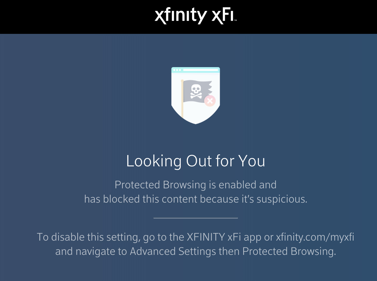

As I thought, somebody (xfinity) is doing a MitM hijack of your SSL connection:
The certificate seems to be valid, at least from my non-xfinity ISP connection. Did you check the date/year on your computer(s)???
Most browsers will give you certificate details if you click/double-click on the lock icon or https:// text on the left of the address bar.
smartweather.weatherflow.com is being hosted on a shared server or load balancer with all of those other hostnames, so it may not be possible for WF to replace that certificate…
You guys (and this forum in general) ROCK! I turned Xfinity’s Protected Browsing off and all’s well. I’m curious about why it just started happening…I checked the dates/times on my computers, and everything’s in synch. And if it was a timestamp issue, I’d think other SSL sites would be affected.
In any case, my issue’s been resolved. Many thanks to all for the assistance.
