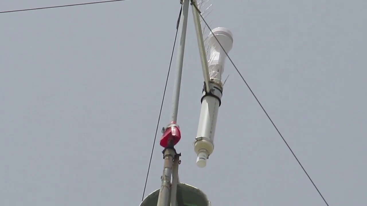

Hi @caredlands,
If you read the wind speed in normal mode every 3 seconds there are more readings to choose from. If you read the wind speed every 15 seconds in power saving mode there are only 4 readings to choose from. From those 4 readings which ever reading is the maximum will be the maximum reading for that minute. So if a gust of wind occurs at 9 seconds past the minute it will be recorded in normal mode but it will not be recorded in power save mode. So technically I would respond to your question with ‘yes’ you loose the hi wind gust.
BUT if the gust occurs at 15 seconds past the minute then you would not loose it.
Here is a video which demonstrates the 3 sec readings as a gust hits my Sky. If the 43 knot gust did not coincide with a 15 sec reading in power saving mode, then it would have been lost.
Does that help?
cheers Ian :slight_smile:
