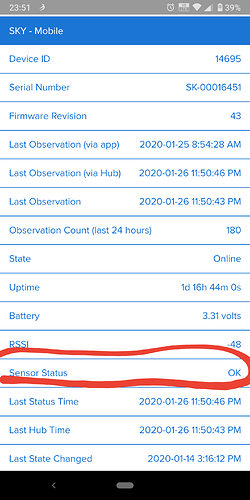

What says the status page about the Sky’s sensors?
(You reach status via “settings” - “station”- in the "status"row click on “online”)
Maybe you post a screenshot of it as well.
It looks like Sky has failed for wind and UV 12 hrs ago. Battery level from Solar is still registering in the app tho.
Last timestamp update from Sky to the app was 12 hrs ago. Wind speed and UV are stuck at the value from 12 hrs ago.
When I look at the graph of battery, however, it stops when everything else does. You may want to try power cycling the SKY.
What does the sensor status field tells you?
For sensor status you are looking for a screen like this:
In addition to how @dsfg said to find it you can also find it by viewing your station with a web browser and clicking the green dot at the bottom of the page where it says online.
Sky showing Offline as expected. It just appears frozen for the display but is offline. Power cycling Sky is not an option at this time of year here.

I see no apparent reason except some sensor failure. Can you have a look on your page (green bullet down to push and in sky section) … under sensors any set as failed ?

Wind came back again, so just UV failure now. They change like the damn wind :slight_smile: The Wind sensor was listed earlier.
That said, I take all the sensor reports with a pinch of salt. My air has listed the humidity sensor as failed for months, but its working just fine:
