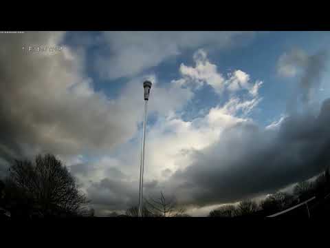

once you make a timelapse, you could almost understand why I have extreme rainfall, without a single drop.
(but usually it just sways a bit in the wind without a lot of false rain)

yeah it is pretty windy, with speeds over 60km/h, but I’m really puzzled why the rain is reset before 17:40 in the highest zoom level. Seems like a strange bug.
