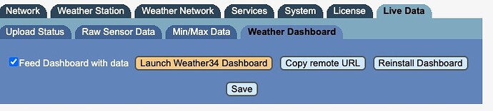

Hi
Running Meteobrige on a RasPi4b. Trying to get it to load a Weather 34 dashbord but just coming up with an error?? Probally something simple.
Is Weather 34 hosted locally on the meteobridge?
Thanks
Hello Alexander
I think you’ll have more chance on the meteobridge forum. Some of us use it but not sure you’ll get much solutions here. Try on the meteobridge forum (Boris doesn’t come here to often)
